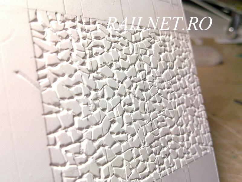

Dupa realizarea proiectului se traseaza placile din plastic. Se incepe cu corpul principal. Componentele turnului raman laolalta pana la trasarea pietrelor. Pentru a reda cat mai realist bolovanii, fiecare dintre acestia se realizeaza manual cu o surubelnita de mici dimensiuni. Urmeaza decupajul ferestrelor cu un cutter dupa care se finiseaza.
After the project is ready, the plastic boards are being mapped. It begins with the main body of our construction. The tower’s components are staying together until the stones are being drawn. For a more realistic reproduction of the boulders, each of them are manually accomplished with a small screwdriver. Cutting and finishing the windows using a cutter, is the next step.

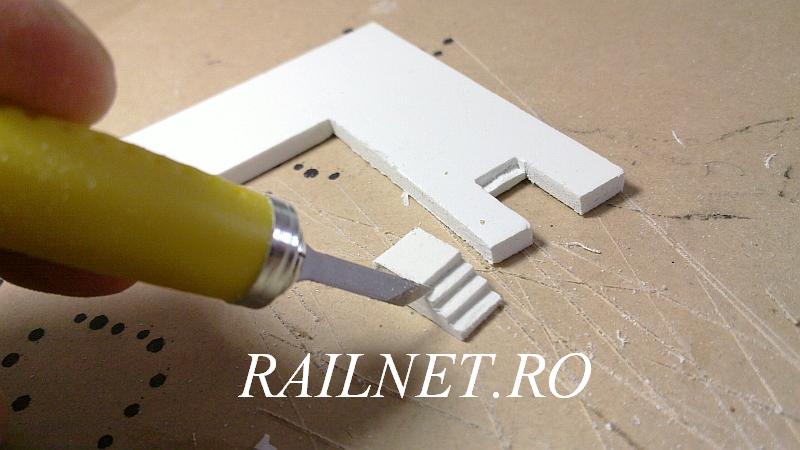

Se decupeaza cu grija fiecare perete. Every wall is carefully cut up.

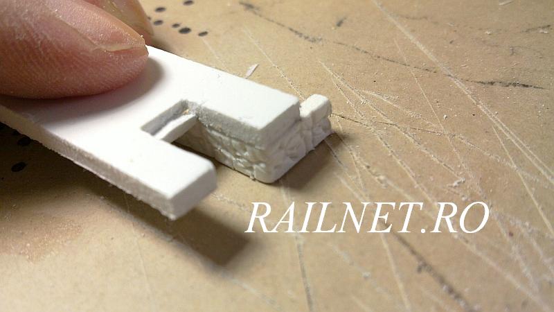

De remarcat faptul ca marginile corpului principal au o structura ca de caramida pentru a le pune in evidenta. Notice that the main body’s structure edges, have a brick-like shape in order to highlight them.

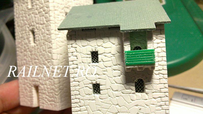

Corpul principal ar arata cam asa: / The building’s main body will look like this:
Dupa asamblare “turnul fortificat” trebuie rectificat la muchii ca sa nu se observe imbinarea. After the assembling the “fortified tower” it’s edges must be corrected in order to hide the assemblage traces.
Structura de piatra a peretilor este conceputa in asa fel incat creeaza impresia de continuitate. The walls stone structure is designed so, to create the impression of continuity.
Se incearca diverse variante de asamblare. Different ways of assembling are being tested.
