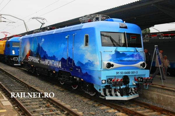

The new Trans Montana electric engine from Softronic / Photo: Daniel

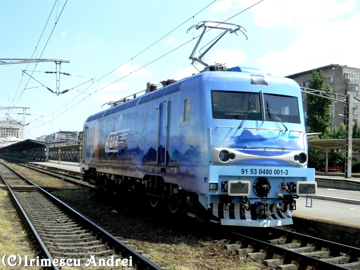

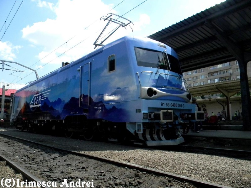

Locomotiva Trans Montana iin Gara de Nord - Trans Montana in Gara de Nord Station, Bucharest.jpg
Locomotiva Trans Montana in Gara de Nord - Trans Montana in Gara de Nord Station, Bucharest / Photo: Daniel

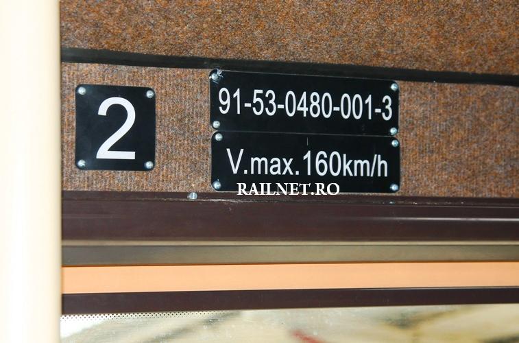

Inscriptie din postul 2 - label from cab nr.2 / Photo: Daniel
