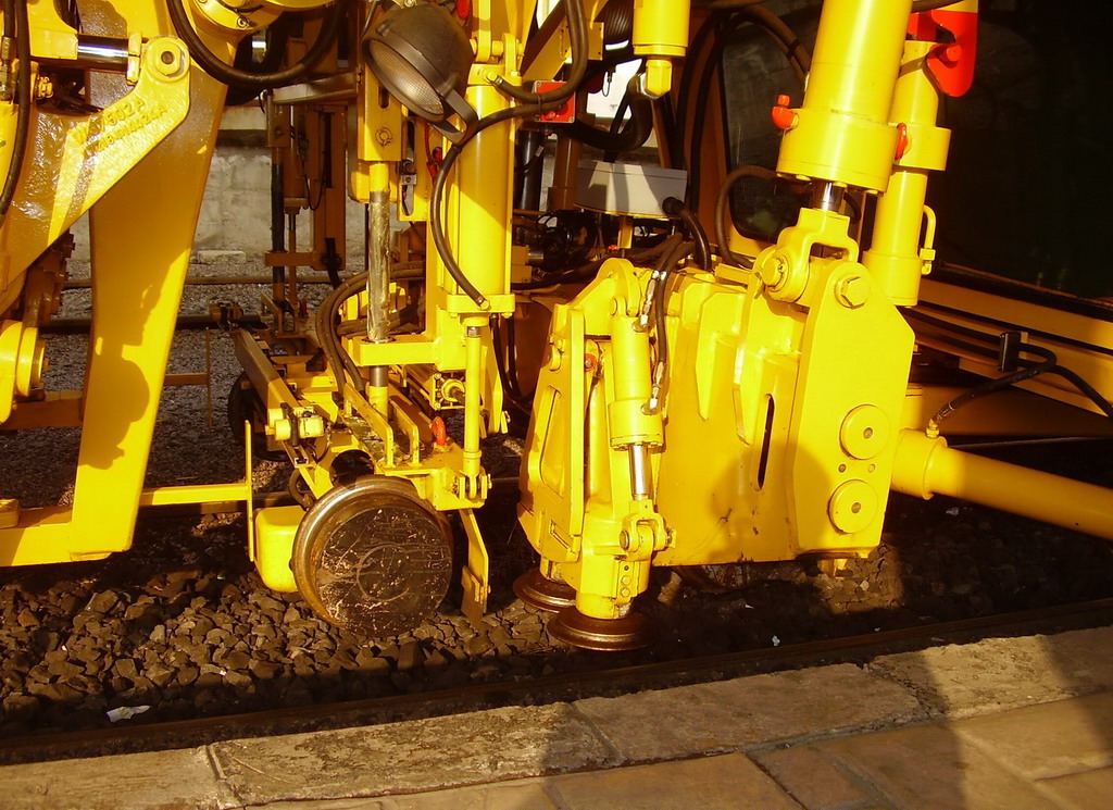

Tamping units
Two independent action tamping units are mounted directly in front of the rear bogie. The sub-frames are laterally displaceable, which permits automatic centering of the units over the rails during work in curves. The two heavy-duty tamping units work according to the well-proven non-synchronous uniform pressure tamping principle. Force equilibrium between the tine pairs, directional vibration in the squeeze direction and the ideal vibration frequency of 35 Hz guarantee completely uniform tamping.
The following models are available:
* Duomatic 08-32: two two-sleeper tamping units with a total of 32 tamping tines for tamping two sleepers per tamping cycle.
* Plasser 08-16: two single-sleeper tamping units with a total of 16 tamping tines for tamping one sleeper per tamping cycle.
Sleeper-end consolidators
On request, hydraulically powered sleeper-end consolidators can be mounted level with the tamping units or the rear bogie. During tamping these fill up the empty gap occurring at the ends of the sleeper during the lining process. This permits optimum fixation of the track in lifted and lined position.

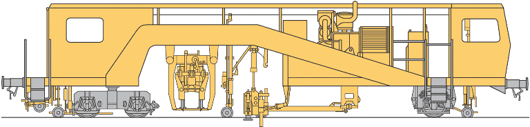

Technical Data
Length over buffers: 18 710 mm
Height over top of rail: 3 285 mm
Width: 3 050 mm
Bogie pivot spacing: 1 1000 mm
Bogie wheelbase: 1 500 mm
Wheel diameter: 730 mm
Gauge: 1 435 mm
Design possible in gauges from 1 000 mm to 1 676 mm
Machines mass approx. 42 t
Axle loads of front bogie: 10 t each
Axle loads of rear bogie: 11 t each
Engine output: 240 kW ( 326 HP )
Maximum traveling speed:
Self-propelled: 80 km/h
Towed: 100km/h
Drawing
